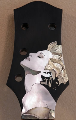

Craig, my questions are pretty straightforward materials questions regarding the fabulous Madonna inlay:
1) What is Pearl Grav-Lam and where can you get it?
2) I can't tell from the photo where you used the silver, white MOP, white River Pearl and Pink Mussel;
3) What material did you use for the clothing.
4) I gather the eyelashes are ebony.
(In the kazillionth edition of Guitarmaker when I am featured -- I'll anotate my pictures identifying the inlay material used).
The thing I find so remarkable about the Madonna inlay is the life like quality you achieved without going over board with too much graving detail. The thing I meant to comment on when you originally posted the inlay on the OLF was your characterization that it is Laskin'ish. I've seen a lot of his work and pictures of your work and in person at ASIA, for what its worth I think your work is unique. I marvel at Laskin's skill but find some of his work too much. So in my humble opinion, you do yourself a disservice comparing your work to his.
I hope you enjoy your time to yourself.   You'll be amazed how soon you'll miss them.Anthony Z38589.0757986111

O.K Anthony.
I used to feel the same frustration as you looking at others work. They would give lists of the materals used, but I never could figure out where they all were. Here I am doing the same thing... , but there has to be some mystery to this, or it's boring!
1) Grav-lam (not sure about the spelling) is real mother of pearl (gold, black, or a variety of others) that Chuck Ericson developed I believe. It's a top layer of actual solid heat-bent pearl on a layer of cheaper abalam as a thickness builder/backer. It allows a much larger seamless piece of material that can be fully engraved, but the top layer is a mere .02" thick. It's easy to sand through, or over-thin to the point of it not being workable. The bottom layer is relative junk. It's only for flat areas, no radiuses if your a beginner. I used it once on a radius, but I kept the pieces to the edges of the curve where I knew they would lay flat enough to keep intact.
The hair is about 25 or so seperate pieces of gold pearl, with some black pearl for highlites, the bottom blacked out area of the hair/back of the neck is a seperate piece of ebony I pierced to allow for better control of the tiny gold pieces. Just routing for them would be to messy. The different grain also adds a little more sense of coherance with the rest of the hair, and doesn't just fade it completely into the wood. The lips are pink mussel, the teeth white river pearl, the entire face is one piece of grav-lam, the shoulders on down are solid mother of pearl, with a seperate piece for the chest, the eyelashes as well are ebony, The jacket is four pieces of black pearl, chosen for their grain, the main piece gives off a rippled leather like effect, with white highlites. It looks like her face is shining off in it in the lights, and the zipper and button are sterling silver. The only way I could do the face in that size was with grav-lam. Real pearl just isn't available in that size. It's sold by the piece, or by the ounce. If I remember it's not cheap. Rescue pearl as well as Chuck both sell it.
Hope this helps.

PostPosted: Thu Aug 25, 2005 12:50 am
Here is a pic so it will make it easy to reference what Craig is talking about.
